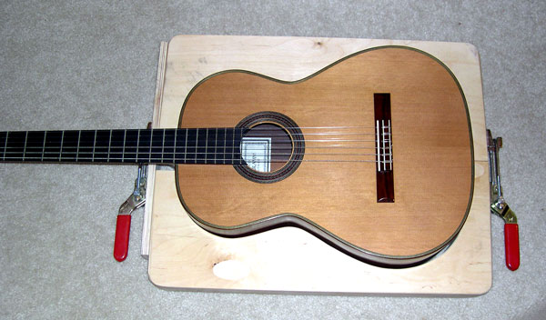

I just received a great new mold from John at Blues Creek, but this isn't just an ordinary mold. Check out the picture below:

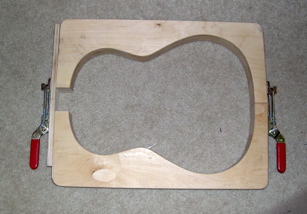

At first glance it looks like any other mold, but see if this next picture helps you spot the modification:

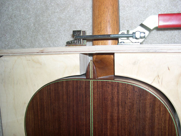

Yes, that's right, finally a mold that will accomodate classical guitar construction with a spanish heel. This mold is straight from Robbie O'Brien's dvd and is a great improvement over the solera listed in the Cumpiano book. There are a ton of great ideas on Robbie's dvd's, and John Hall was able to modify one of his molds to accomodate. As you can tell, I'm pretty excited about this new mold. I've been jealous of the great molds all you steel string builders have always had. Here's another pic from the back:
As you can see there's plenty of room for a spanish heel, and the best part is it will make assembly of the sides/top/back much easier and more consistent. Time to go try it out.

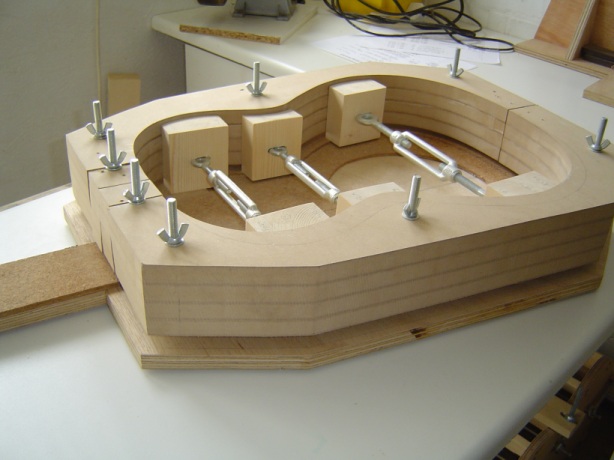

As a steel string builder moving on to classical building I wondered how I would manage without my mould when using a Spanish heel. So, I built this solera/mould the neck block of the mould is removeable for the neck and the mould can be raised and lowered to allow for the soundboard overhang, until it is flush trimmed. I will also use the mould off of the solera with the neck block fitted as I like this body shape (Torres FE19) and intend using it as a little 12 fret steel string mould.
